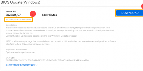

This is a basic issue of any technique. https://www.asus.com/support/FAQ/1008276/ How to update BIOS in Windows | Official Support | ASUS Global asus.com or
